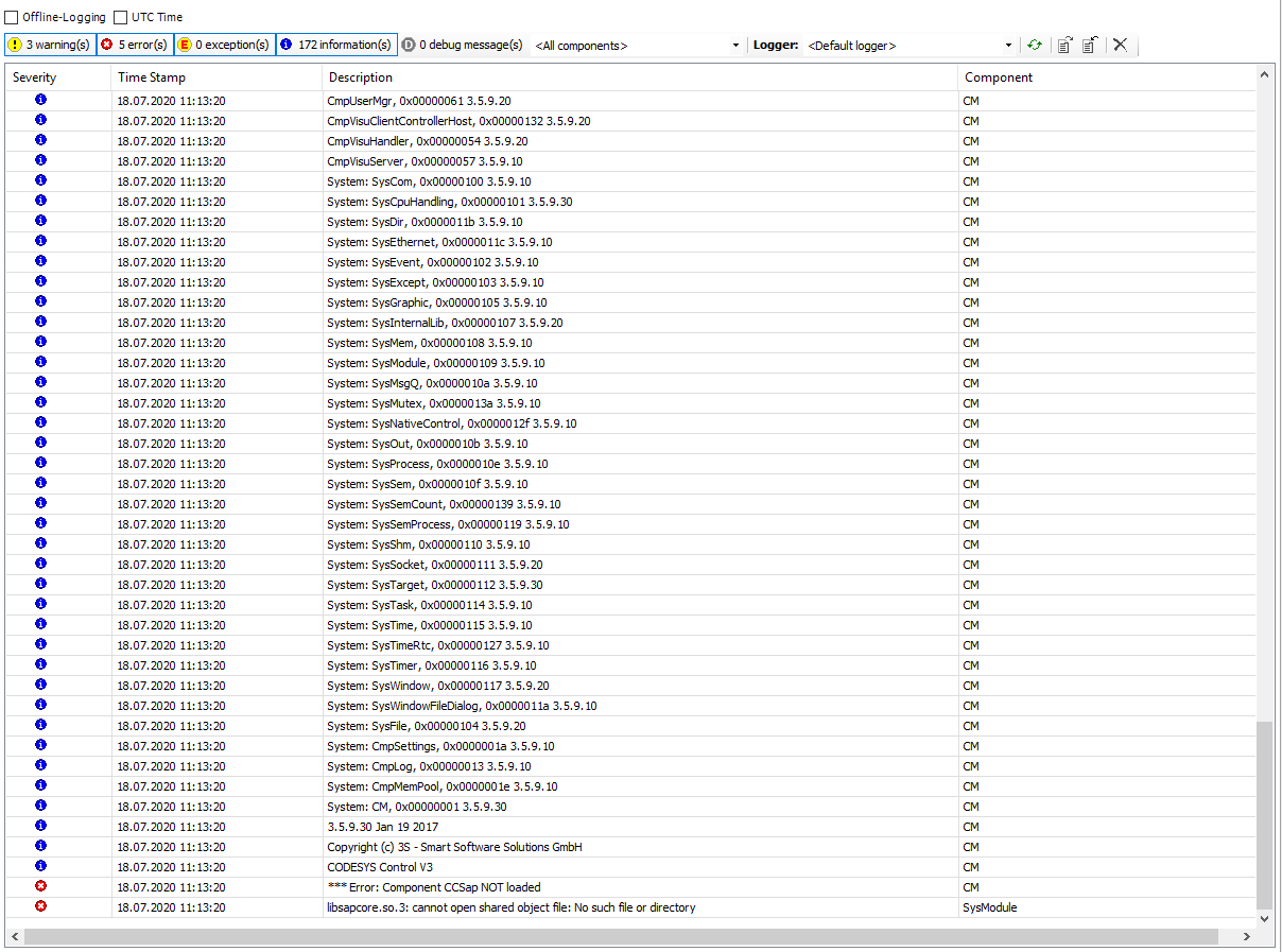

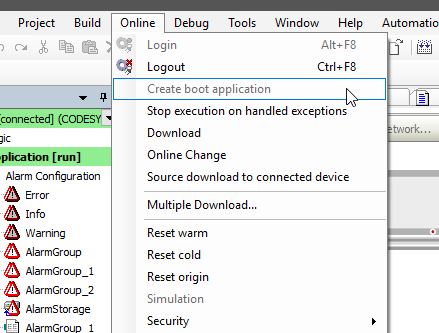

    Hi,
    I am wondering why my Codesys's "Create boot application" option is grayed out and I cannot click it? I tried restarting my PLC and re-installing the Codesys runtime on the PLC, and restarting my Codesys IDE, but this is still happening.
    Thanks,
    Jefferson
  • eschwellinger
    eschwellinger - 2020-07-18

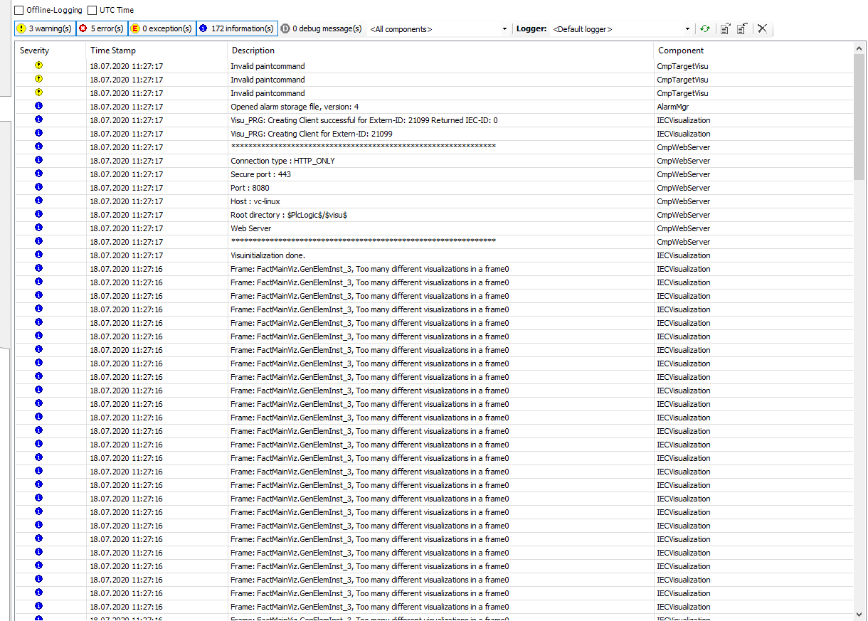

    Hi Jefferson,
    no real idea at the moment I would check the plc logger.
    BR
    Edwin
  • jeffersonhui - 2020-07-18
    There doesn't seem to be anything unusual unfortunately...
  • jeffersonhui - 2020-07-21
    I factory resetted the PLC and that seemed to work! The "Create boot application" is back now.
