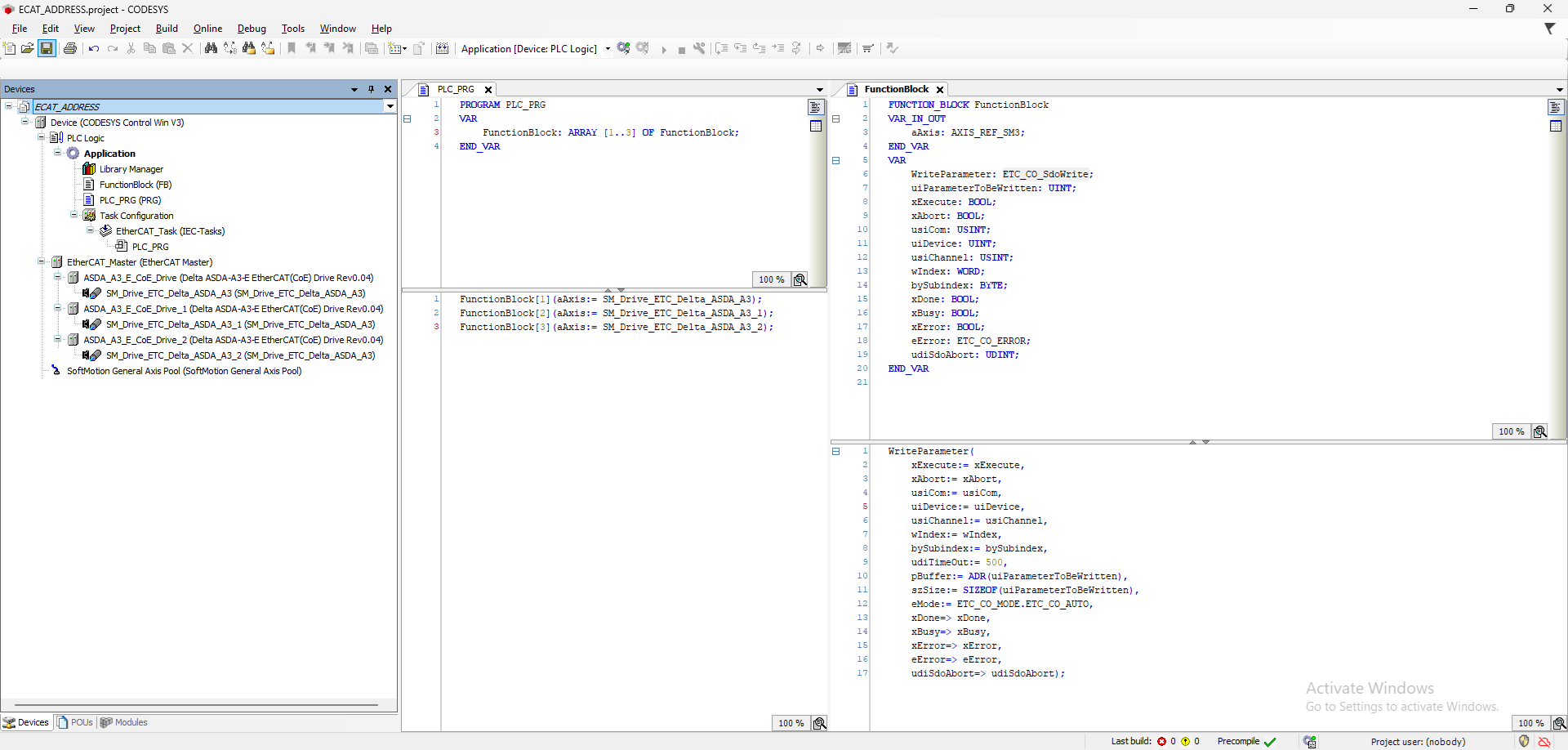

I'd like to write some parameters to axes from inside a function block where I passed axis by reference, using ETC_CO_SdoWrite. Is it possible to get the device address from inside the function block?
I'm afraid I was not clear on what I was trying to achieve.
I'm trying to change parameters and command axes from inside a function block and the first thing that came to my mind was pass both the EtherCAT slave and axis to the function block (as image attached). But, I believe it's worse than just pass directly the EtherCAT slave address to the function block (is it???). However I was wondering if there was a way to get the EtherCAT address directly from the axis, so I don't need to pass the EtherCAT slave nor the EtherCAT address to the function block.
Hello,
Please see example below.
Thank you!

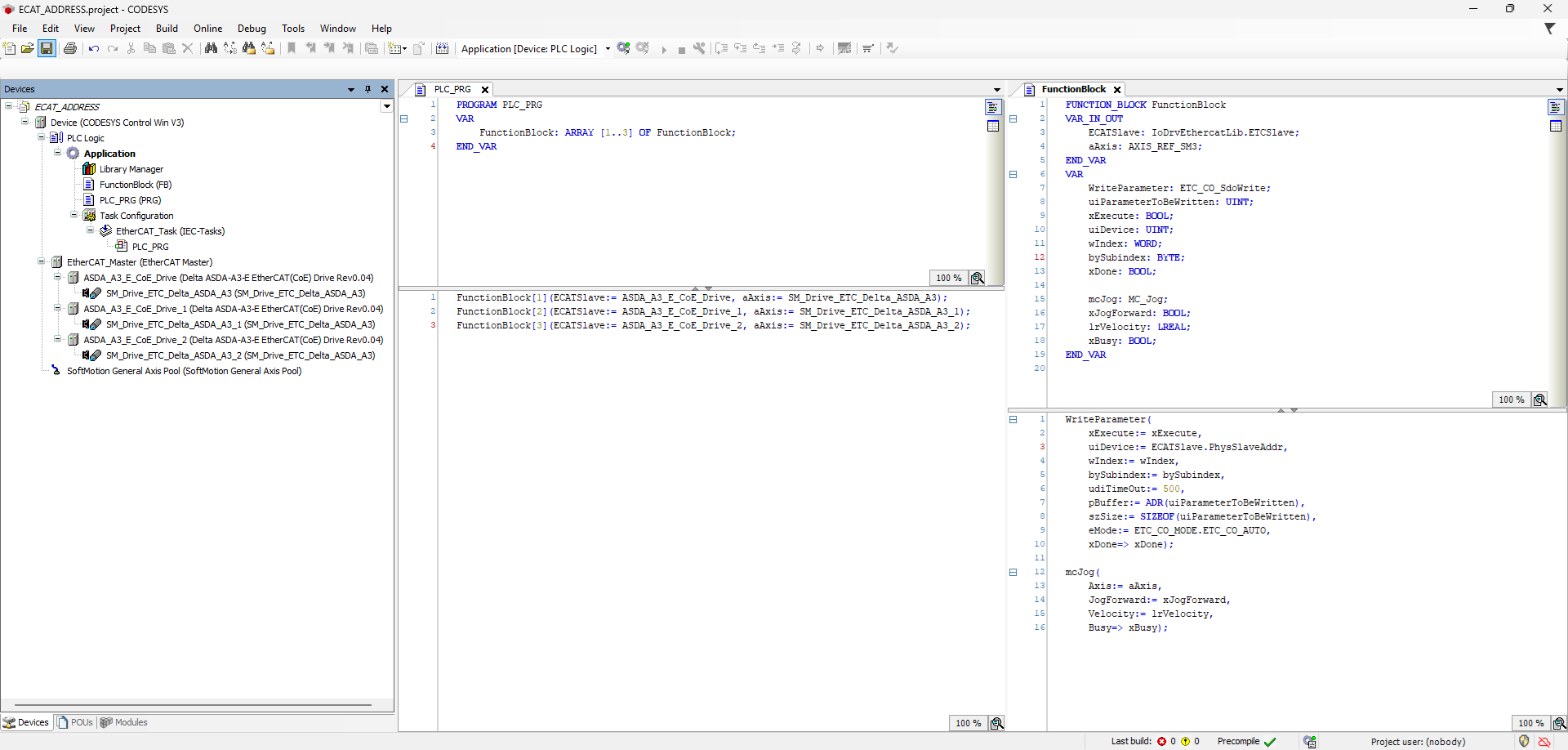

Hello
SDO will write to the drive, not the axis, so you need to pass in the ethercat slave:
VAR_IN_OUT
Axis: IoDrvEthercatLib.ETCSlave;
END_VAR
Then you can get the address with:
Axis.PhysSlaveAddr (as UINT)

Hello,
Thank you for your answer.
Thank you again!
