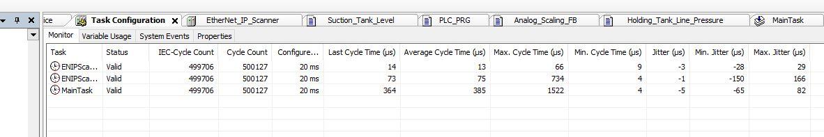

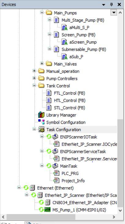

What is the task configuration? When you are online and look at the task monitor, what does it show? (Put a screenshot here). If the processor is overloaded you'll likely need to increase the cycle interval, disable the watchdog, or change to a cyclic task instead of interval based? Also, You might want to adjust your task priorities so they don't all have the same priority.
Just a few thoughts, although looking at the task monitor would help in troubleshooting.

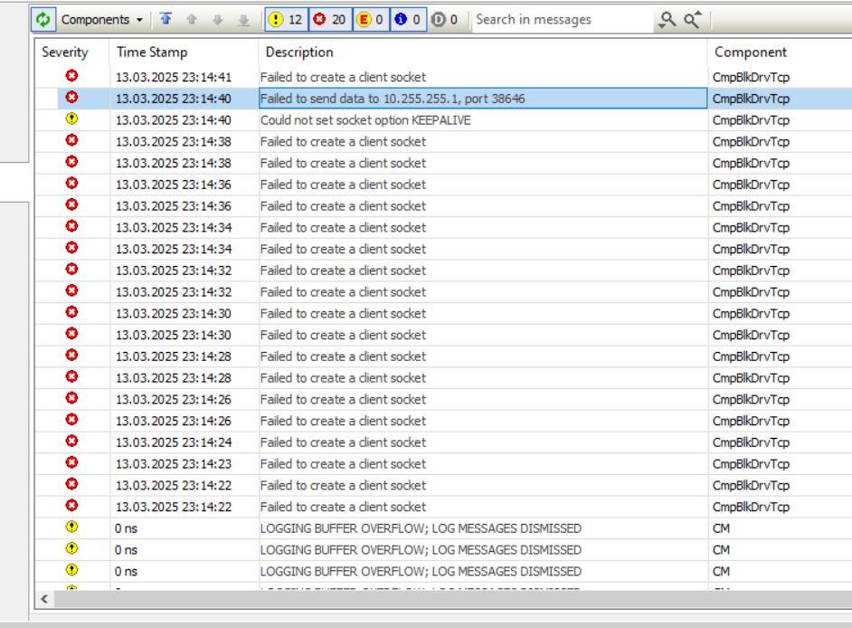

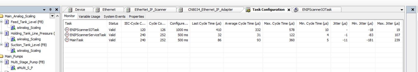

I was out on site the other day as it had done it again and changed a few things like cycle time etc. plc load is only 7% at its highest.
I took a few screenshots while i was there to add to this post.

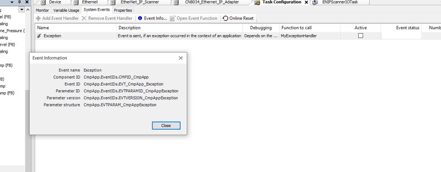

exception[ProcessorLoadWatchdog] occurred in: App=[all], Task[all]
I have to reboot (power cycle) the system to clear the exception. or remotely restart the application.

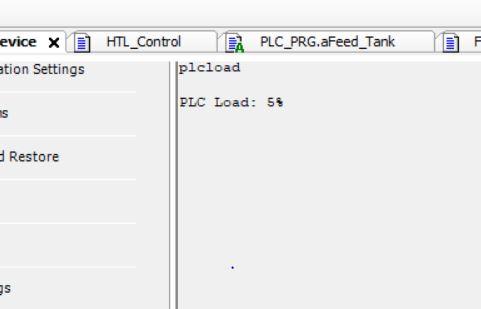

You could check the plcload in the plcshell by 'plcload'

plc is at 1%

Same here. plcload in my case is about 7% while running.
Watchdog ENIPScannerIOTask was about 200ms. Max cycle around 6ms, normal cycle time 4ms.
Probably just increase the watchdog to 2000ms? or so...

I don't have watchdog enabled in tasks?
