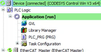

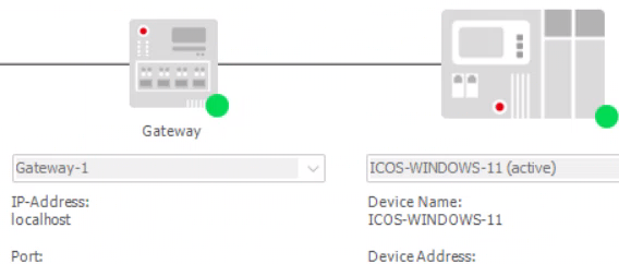

Here is what I use to read online the parameter value.
proj = projects.primary app = proj.active_application plc = proj.find("Device", True)[0] onlineapp = online.create_online_application(app) onlineapp.login(OnlineChangeOption.Try, True) dev1 = proj.find("DEV1", True)[0] for conn in dev1.connectors: > parms = conn.host_parameters > if len(parms) > 0: > p = parms.by_id(1074855985) > p.read_online_value(2000) ---> error: Gateway not configured properly
