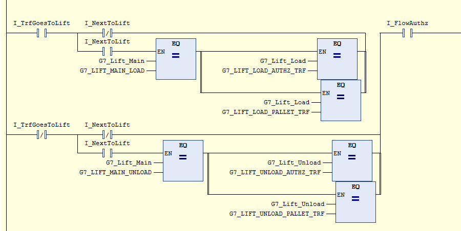

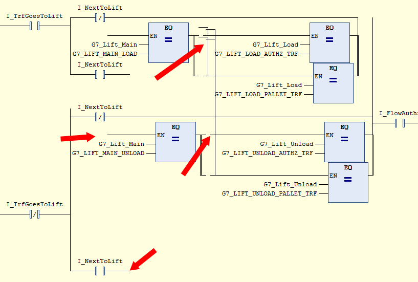

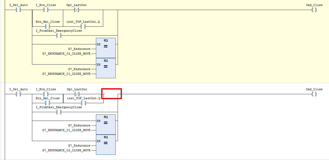

Hello,
With Codesys 3.5.21.10 the ladder editor displays :
With Codesys 3.5.17.21, the same code was correctly displayed : The compilation is error free
Please check image attached
Can a Codesys member explain this ?

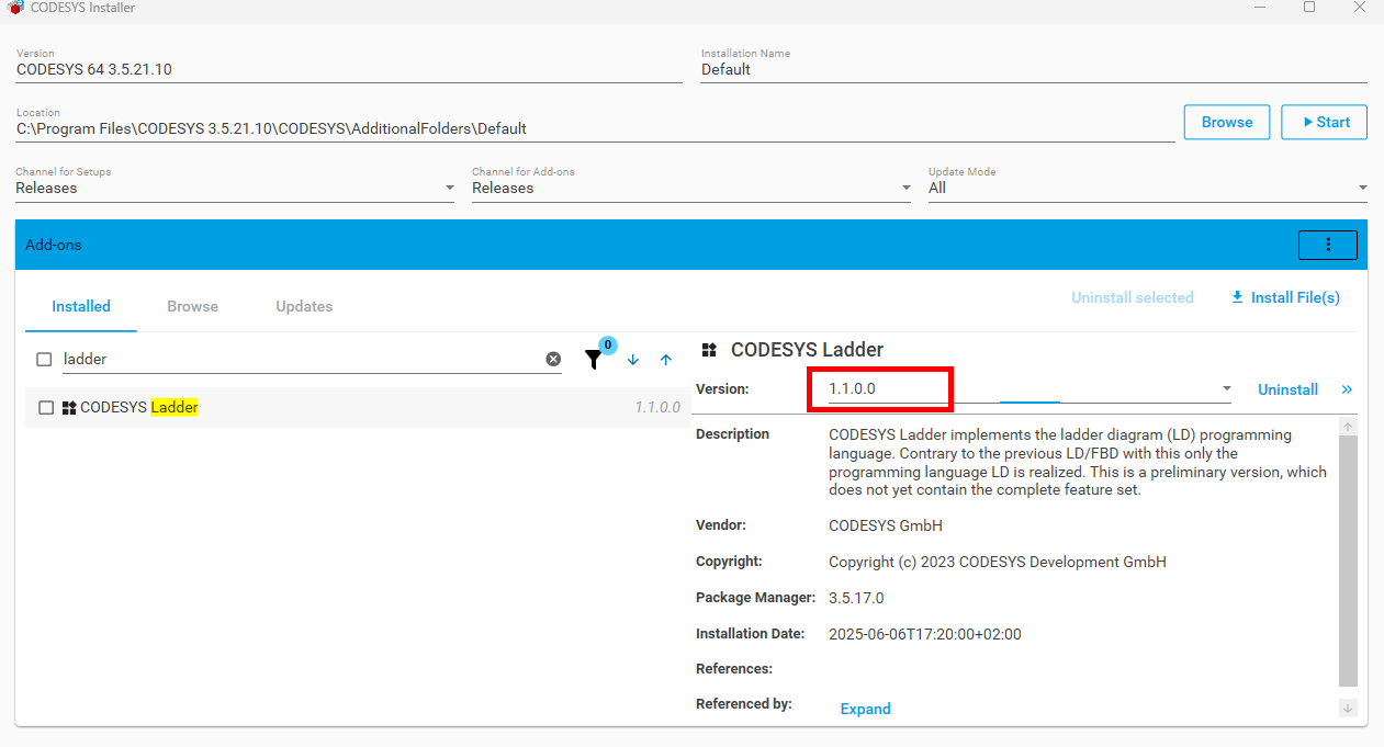

which ladder plugin version? CODESYS version is not enough information since modularisation.
Ladder version is 1.1.0.0
Hi, could you please update to Ladder 1.2.0.0 via CODESYS Installer and check if this is still in?
The update via CODESYS Installer fails (admin mode). Anyway I am switching all my POUs from Ladder to ST because Ladder cannot be used like this.
