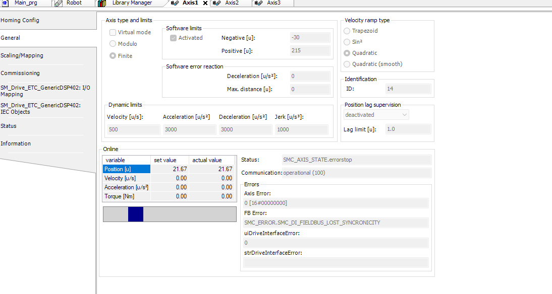

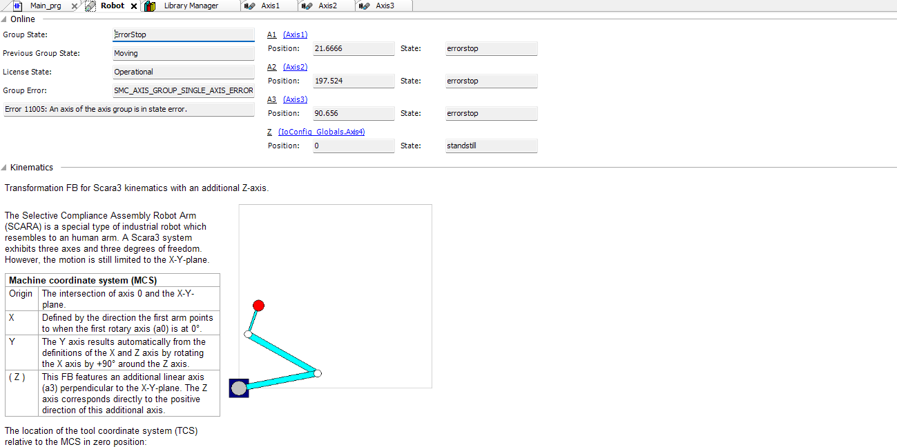

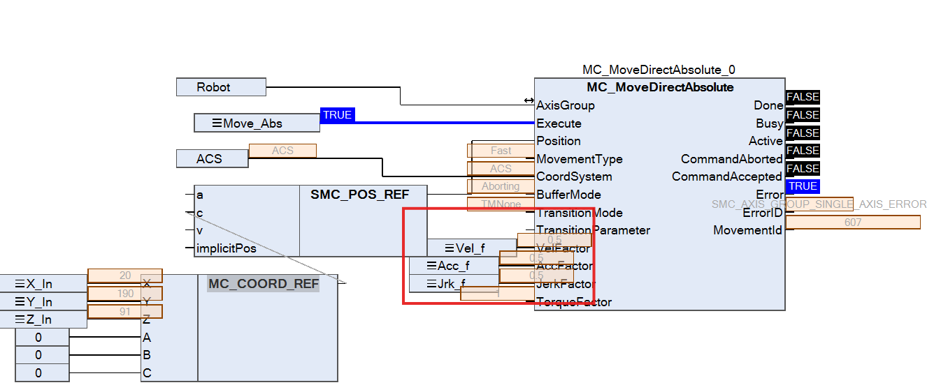

    I am using Scara3 kinematic with EtherCAT PLC. The robot stops at the same place randomly after few cycles.
    Check attached image. I am getting SMC_ERROR.SMC_DI_FIELDBUS_LOST_SYNCRONICITY in all 3 axes.

    Hi aniket-b,
    this error has nothing to do with the scara3 kinematics, or robotics, or SoftMotion.
    It means that the EtherCAT bus is not synchronized. The usual cause is that the realtime of the PLC is not sufficient.
    See https://content.helpme-codesys.com/en/CODESYS%20SoftMotion/_sm_basic_common_errors.html for details and ways to solve the problem.
    You can also check the PLC log for additional information about the error.

    • aniket-b - 2025-12-23
      Thanks Georg for responding.
      I have followed the suggestion mentioned in the real time problem.
      However, it does not solve the problem.
      The weird part is, the robot stops at the same position randomly and it does not stop when I increase the speed of the motion.
