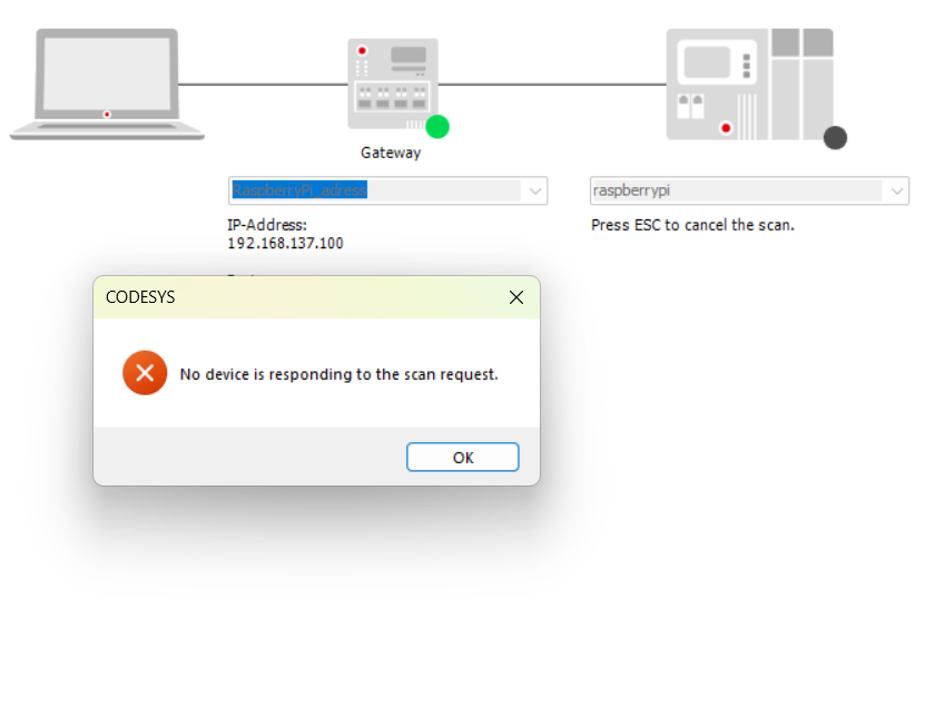

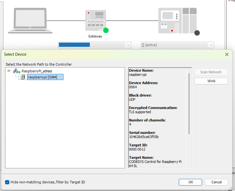

I'm trying to use a raspberryPi 5 as a PLC. I fixed its IP address, I can ping it. I've also installed the CODESYS Control for Raspberry Pi 64 SL runtime on it. So I've created a gateway (IP address of the Raspberry, TCP port 1217). I see the green dot next to this gateway. When I do a network scan, I can see my raspberry (see photo).
When I try to connect to it, I have to define an administrator profile, which I do. On validation, I see a message: No device is responding to the scan request.
I've checked that port 1217 is listening on the raspberry, I've uninstalled the runtime then installed it again, but I can't connect.

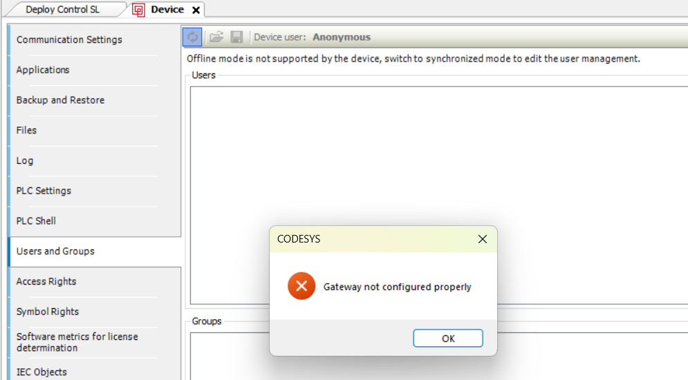

Also, when I try to configure the user groups before connecting, I see that Offline mode is not supported by the device, even though I'm connected to it in the Deploy Control SL tab. When I try to refresh, I see: Gateway not configured properly.
How can I connect to my Raspberry? Have I defined my gateway incorrectly?

Do you use the same type Raspberry PI64 SL in the device tree?
Which version of the Pi package / Runtime do you use? 4.16.0.0?
Last edit: eschwellinger 2025-06-12
Thanks for your answer. In the device tree, I also use CODESYS Control for Raspberry Pi 64 SL, version 4.16.0.0.
DO NOT use the same username and password in Codesys as your default Rpi OS admin user on the Pi.
