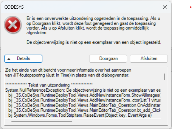

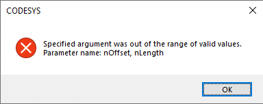

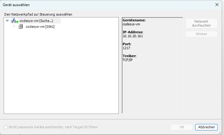

I have the following setup:
Proxmox PC with a debian 13 VM running CODESYS Control Linux SL and Edge Gateway.
Installation method was through the Deploy Control SL and went rather smoothly.
In my Device Tab I find the gateway and when scanning my network I also find my runtime.
I want to connect and get promted that I should add a user.
After setting up the user I get an error saying, that the device is not responding my scanrequest.
Deploy Control SL Operation saying everythings up and running. I can confirm that from the terminal on the VM with "systemctl status codesyscontrol" and "systemctl status codesysgateway".
I am running out of ideas how to fix that issue. Can anybody help? Screenshots attached.

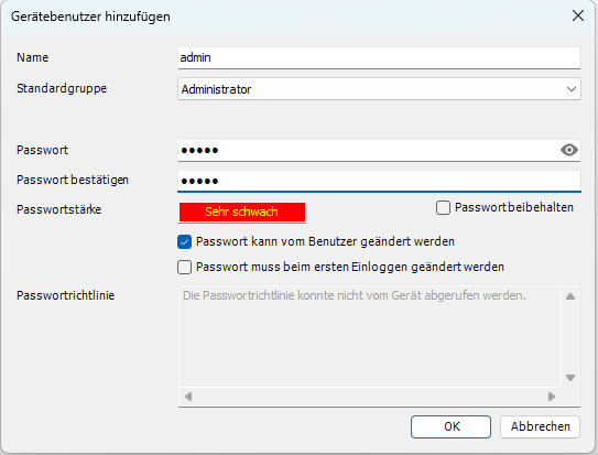

for me looks like you do not use latest CODESYS IDE version,
there is a known bug if you use a newer runtime your are forced to use a more complex password as user for the login.
The old IDE version does not show this problem on login.
so either update CODESYS or use a pw which meet the complexity requirements.

thank you eschwellinger. That one solved it for me.
The password must have a length of at least 8 characters.
The password must consist of at least 4 different characters.
The password must contain lowercase letters.
The password must contain uppercase letters.
The password must contain digits.
The password must contain special characters.
