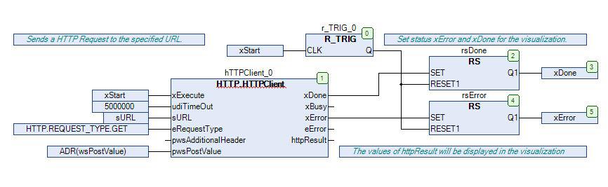

First request: I would like to use codesys to talk to devices that require a RESTful API to interact with them (Or any server that uses this interfacing mechanism). How can i send and receive these (Get, Put, etc...) commands from within CODESYS and/or WebVisu?
Second request: Is it possible to add Javascript librarys (JQuery or other) to WebVisu and, also to edit the HTML / CSS /Javascript files directly to create more flexible user interfaces ontop of the existing WebVisu design tools?

Try the "HTTP Client Example" from the webstore for REST.
https://store.codesys.com/http-client-example.html

Hello Mr BBQ, once you have installed the IIoT Libs .package, please see the example in:
C:\Users\PleaseChangeThisSoItIsYourUserName\Web Client SL\
