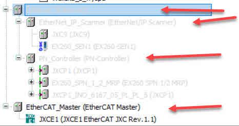

Hello, I tried to communicate the raspberry with a DP I/O EtherCAT (between cable: eth0) and in the same time with an Omron PLC between Ethernet/IP (with wlan0, using an AP in the PLC). And it doesn't works.
It communicate succesfully separately. If I try to use only Ethernet/IP it works fine. And if I try to communicate only with EtherCAT, it works fine. But when I add the two types of communications in the project, it doesn't work.
I guess that I'm not configuring well the task's, but I don't know. Can you help me?

you need to update the masters in the device tree - >update device Ethercat and update device Ethernet IP
and Update Profinet..
and sure if you want to use Ethercat - and any of the other at the same time you need to have Ethercat on an separate network interface. ( PN and EIP could be on the same)
Hi, I updated device. But it was not a problem. The problem was in network connection. I had ethercat device connect to one router with Profinet and ethernet devices. Now i have profinet and ethernet connect via wi-fi and ethercat via network card and almost all work fine. i have problem with ethernet device JXC9 connect via wifi (router WNDR3700v2) . info from loger con not connect to IoDrvEthernetIP. IF i connect via network card everything work ok.
Do you have any idea?

All libs are updated..you need to attach the project
Yes.all library was update:( in attachment i send you project
