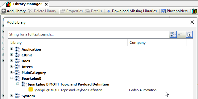

  3. Double click Device > Application > Library Manager
  4. Press the Add Library button and add the SparkplugB library

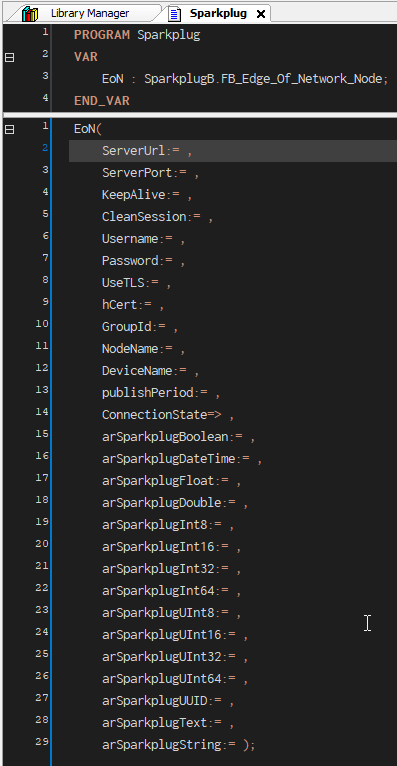

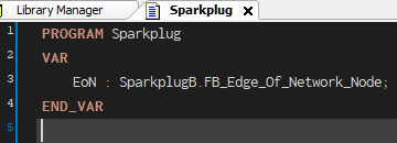

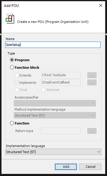

  5. Right click application and Add Object > POU. Call it Sparkplug, Type: Program, Language: ST.
  6. Open the new POU and add an EoN : SparkplugB.FB_Edge_Of_Network_Node;

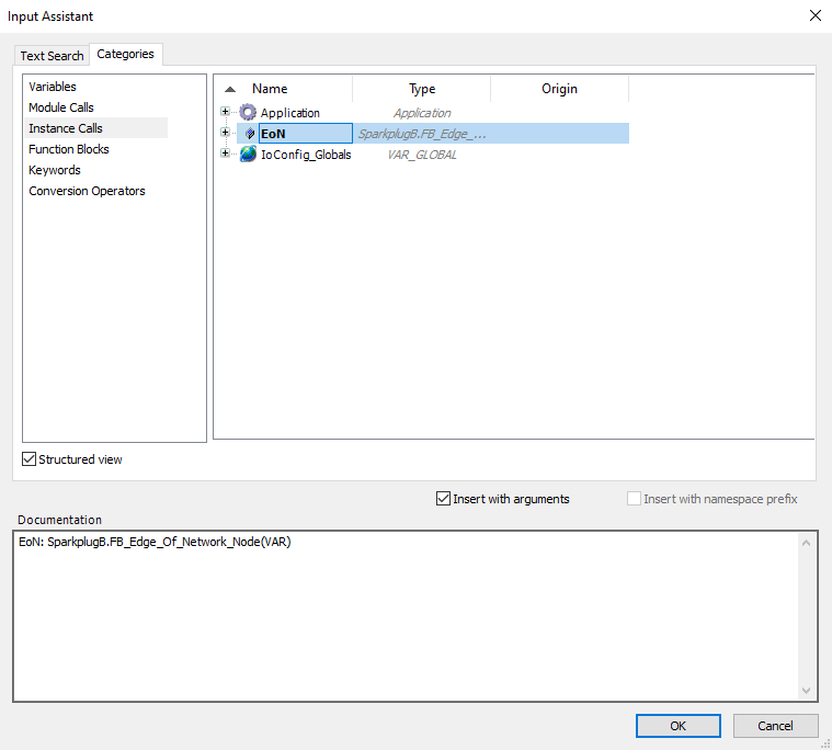

  7. Click the first line of the implementation part of this POU and press F2 to bring up the Input Assistant. Categories > Instance Calls > EoN > Tick “Insert with arguments” > OK
  8. You should now have this view:

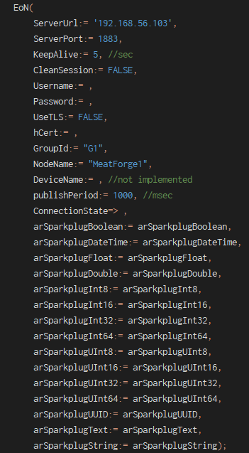

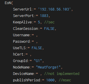

  9. Fill in your server connection settings, eg:

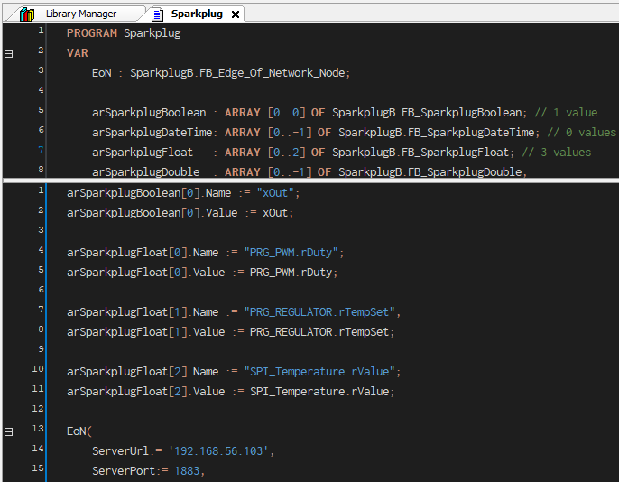

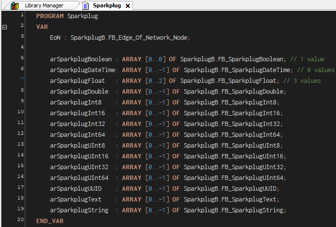

  10. Now there are only a few variables in this project. We need to create a SparkplugB.FB_SimpleValue for each of them, but in an array. Note that each datatype has its own array, and the nature of VAR_IN_OUT means that each array is required.
    PRG_PWM.rDuty: REAL;
    PRG_REGULATOR.rTempSet: REAL;
    SPI_Temperature.rValue : REAL;
    xOut: BOOL;
    a. Declare the necessary arrays. Unused array can be declared with 0 elements =p
    b. Add the new arrays to the EoN call.
    c. Write the names and copy the values in code:

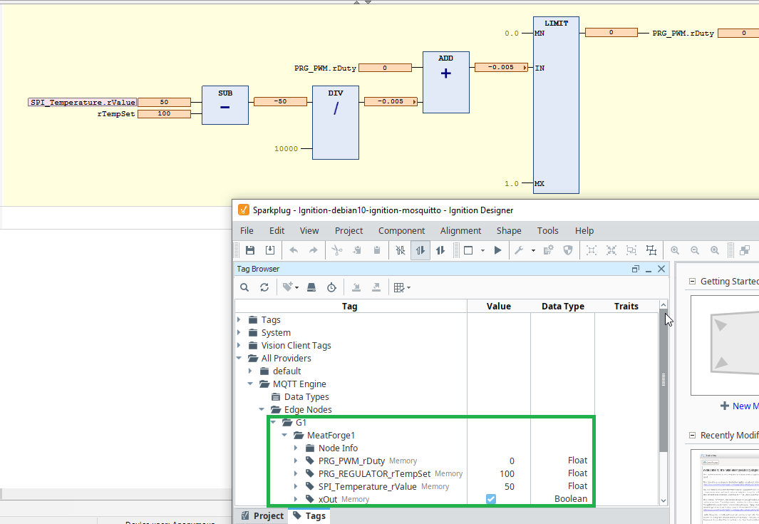

Testing
  1. Now run it and see if you get the values into your Sparkplug B SCADA / IIoT Host Node
