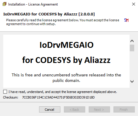

##Package installation
![](https://forge.codesys.com/drv/mega-io/code/HEAD/tree/screenshots/IoDrvMEGAIO%20package.png?format=raw )
[[download url=https://forge.codesys.com/drv/mega-io/code/HEAD/tree/tags/v2.0.0.0/package/IoDrvMEGAIO%20v2.0.0.0.package?format=raw]]
Install the package via;
* Double-click the package or via CODESYS IDE Package Manager,
* Install the loose components via the Library / Device Repository, found under Tools menu option in CODESYS IDE.
