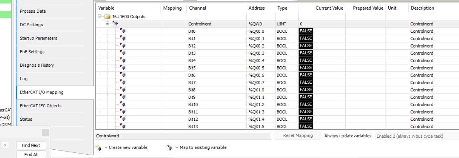

    Current PDO mapping:
    Outputs:
    • 6040 Controlword -> %QW0
    • 6060 Modes of operation -> %QB2
    • 607A Target position -> %QD1
    • 60FF Target velocity -> %QD3

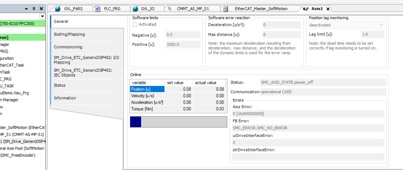

    SoftMotion Axis
    I added a SoftMotion CiA402 axis under the EtherCAT slave:
    • Axis type: SM_Drive_GenericDSP402
    • Axis communication state: operational (100)
    • No SoftMotion mapping errors anymore
    Problem
    MC_Power is executed with:
    • Enable = TRUE
    • bRegulatorOn = TRUE
    • bDriveStart = TRUE
    but:
    • Status = FALSE
    • Busy = TRUE
    • Error = FALSE
    • ErrorID = SMC_NO_ERROR

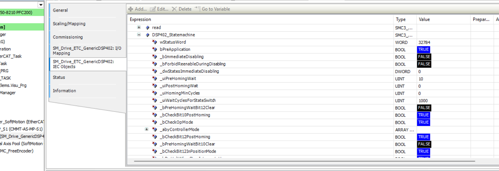

    The axis remains in:
    • SMC_AXIS_STATE.power_off
    • DSP402 state = SWITCH_ON_DISABLED
    The most important observation:
    • Statusword = 32784 (0x8010)
    • Controlword (%QW0) remains 0 all the time
    SoftMotion never writes 6, 7, or 15 to the Controlword.

  • josepmariarams - 2026-07-08
    Try to disable _bCheckBit12InPositonMode in Cia402StateMachine.
