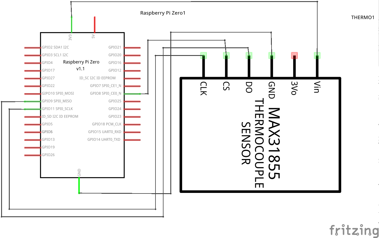

There is an open source tool, which enables everyone to create such neat sketches and layouts:
Fritzing
  • As it is conceptionally easier, you can start with a schematic:
Schematic
  • And for free, you get this nice looking sketch:
Schematic
